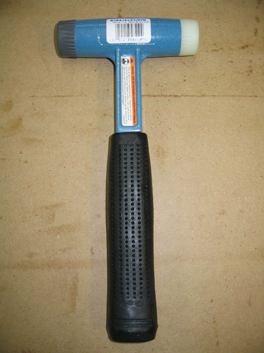

What kind of hammer are you using? In my experience, one like this works far better than others that are sold as fretting hammers. It's a 1 1/4" dead blow with interchangeable faces. For fret hammering, I use the nylon face (on the right in the picture). Works GREAT. Very handy hammer for other uses in the shop as well.

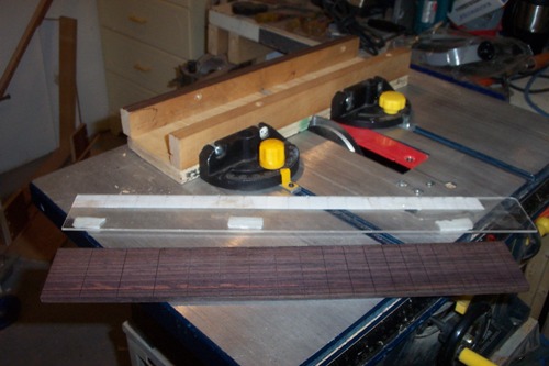

Hey Doug, i use Shane Neifer's fretsaw blade on the table saw to cut the fretboard slots at 0.023", i then use John Watkins' fret press caul and brass inserts to press the ferts in, very easy to use and and accurate tools for this job.
All you would have to do is get the WFRET program for whatever scale length you use and print a paper template that you glue on plexiglass and a carrier board to slide that plexi template when you cut the slots of the fretboard
Here's a pic that gathers all the components you'd need, all that'd be left to have would be WFRET

Thanks for the picture Serge. Next time I am going with a press. I don't do this often enough to get the results I'm looking for.

[QUOTE=Todd Rose] What kind of hammer are you using? In my experience, one like this works far better than others that are sold as fretting hammers. It's a 1 1/4" dead blow with interchangeable faces. For fret hammering, I use the nylon face (on the right in the picture). Works GREAT. Very handy hammer for other uses in the shop as well.
Todd, I can see a great use in my shop for that hammer.
